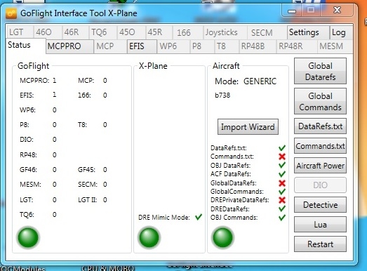

    IXEG and 6abf86179f57dec3c281f93b431bea for this aircraft and i tried B737 with b738 file. any way with out klick import wizard just enough to klick on restart button after that x-plane LED blinking red and aircraft LED red as well . Log massage showing : GoFlight Connection Started . but nothing happening. some times after klicking several times restart button x-plane LED going bright red and not blinking and i ´m geting same massage. and GIT freezing

    i reinstall GIT several times, i think GIT not running properly .for Info. i have win 7 and steam x-plane11

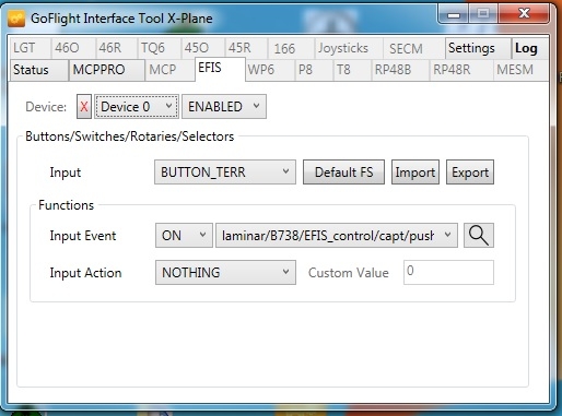

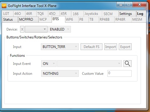

  • With the default 737 with the cockpit showing do the switches, dials, and buttons work when used on the MCP PRO? Is the MCP PRO enabled in GIT?
  • With the default 737 with the cockpit showing ,EFFIS working but MCP PRO not

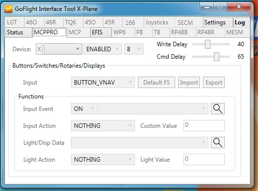

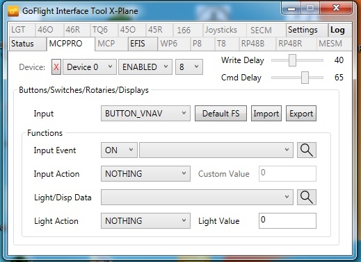

    The pictures, do not show the device 0 chosen. Can you do that for the MCP PRO and do a screen dump of it.
  • I don't have any oder Goflight hardware and plugin that for
    I confirm that both display and switches are not working
    I chose device 0 for both of them and tried again but still MCP PRO not working

  • Ok, there is no config data for the MCP PRO in your config file. Can you try running the import wizard again for the default 737.

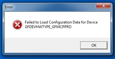

    Ok I did it but geting error message
  • I'm not sure why this is proving so troublesome. I have just tried the same thing on my test PC and the wizard worked first time.
    Can you rename Documents\GoFlight Interface Tool to Documents\GoFlight Interface Tool Old so that we are starting with a clean config. Then run the import wizard, but just select the MCP PRO and not the EFIS and let me know what happens.
