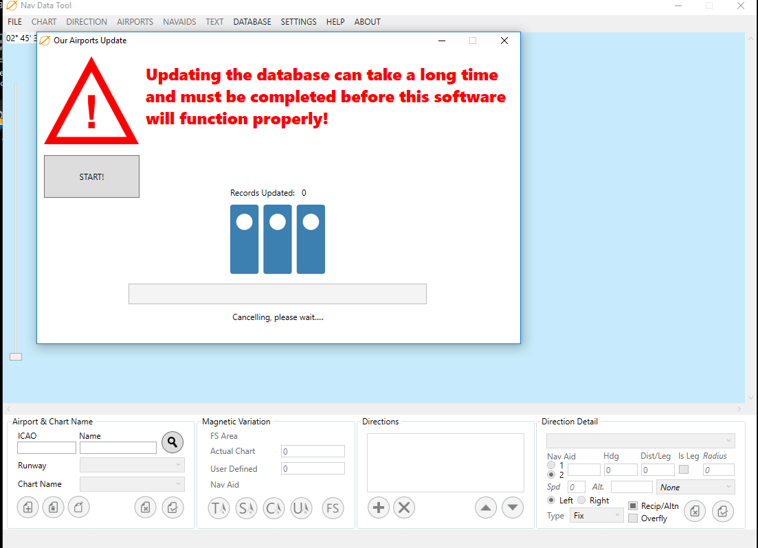

Trying to run Our Airports Update

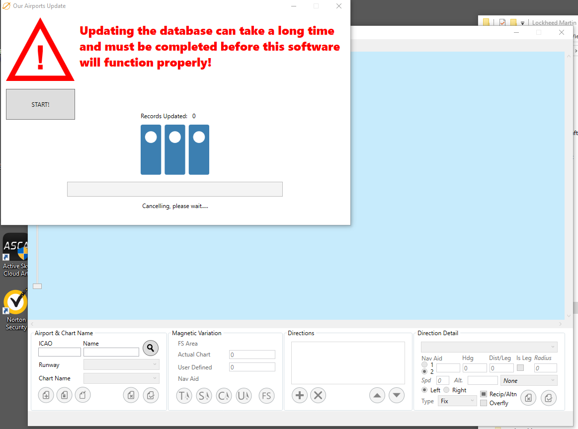

After going through Settings, Sim Scenery, Sim Scenery Area Updates, I start Our Airports updates it says Cancelling, pleas wait. So I wait, and wait, and nothing happens. I push start and I get and error.

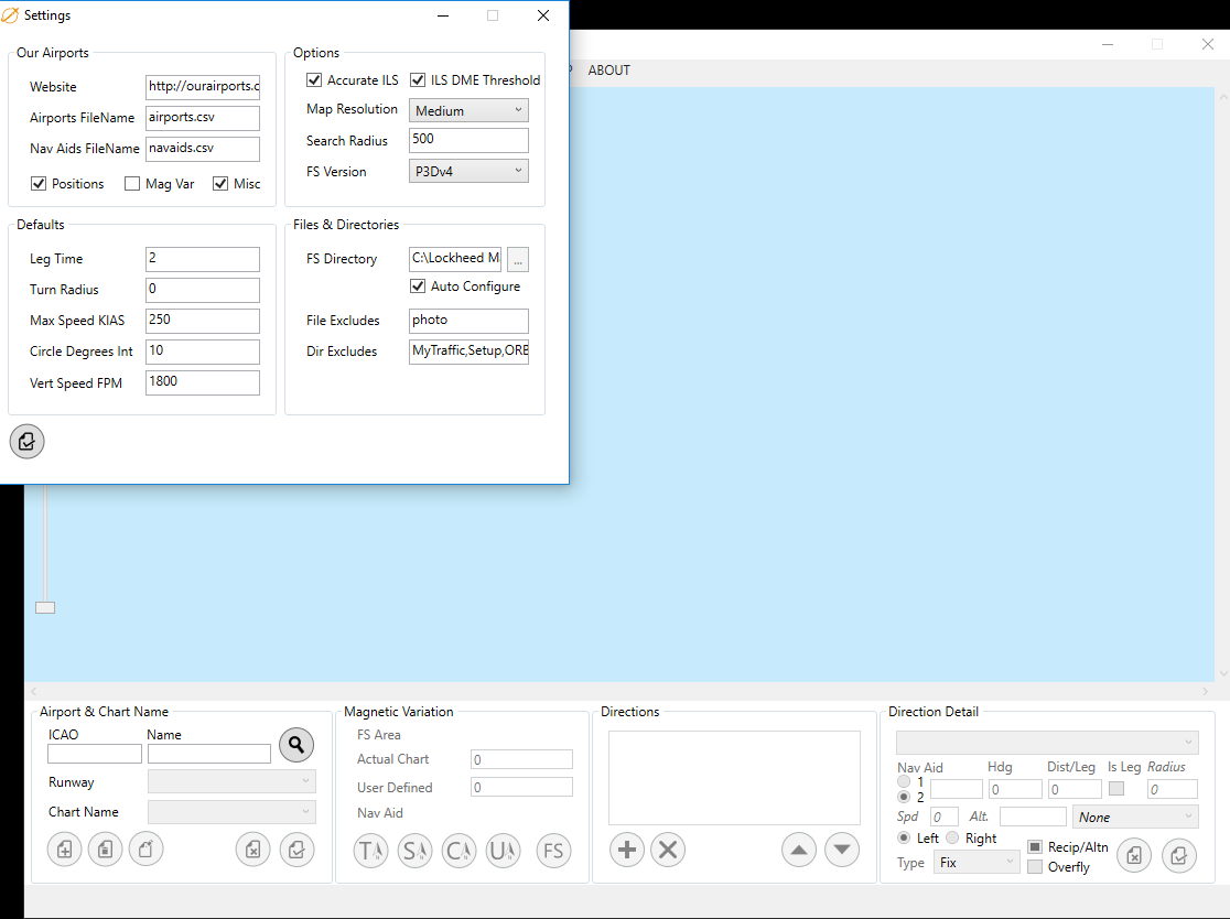

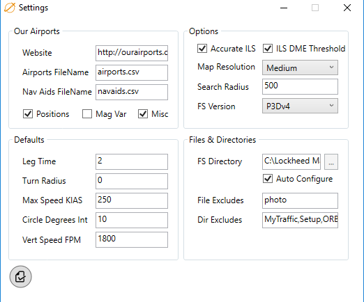

    If you still have the problem can you tell me what you have in the Our Airports part of Settings.
  • Tom, I forgot to add, run the Nav Data Tool as Administrator.
  • I am working on the problem now.
    Thanks for the support. Will be back with you soon.
    Tom Johnson
  • The directories is C:\Lockheed Martin\Prepar3DLockheed v4\
    web site is http://ourairports.com/data
    Dir Excludes MyTraffic,Setup,ORBX\Scripts,OZx\Extras I left this as the default when installed
    All other settings are the default.
    I just tried to run the our airports again and I get Cancelling, please wait.....

  • Yes it does just as soon as I push start it says cancel.
    When I clicked on the http it download a file navaids .cvs and I saved it to my Nav Dat sub folder.
    I opened the file and it 11118 lines.
  • This isn't making much sense because having looked at the code, that message is only shown when the Cancel button is clicked and that only appears once Start has been clicked. You are not double clicking the Start button are you?

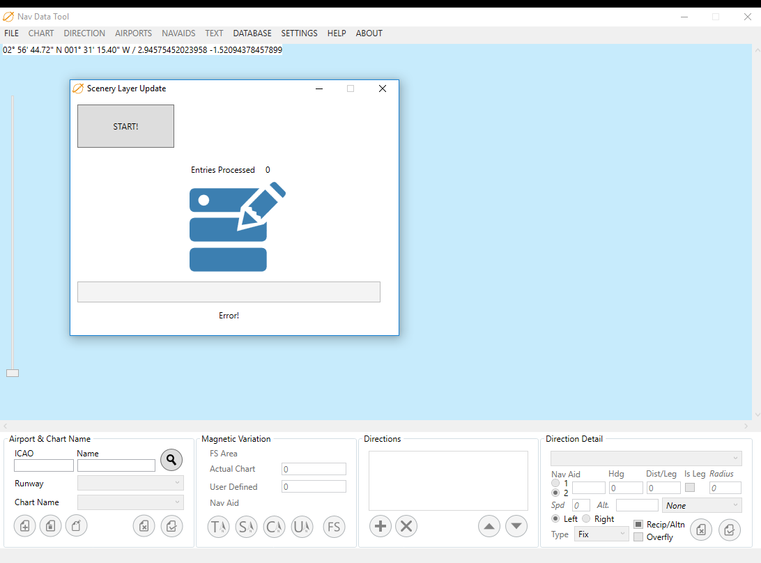

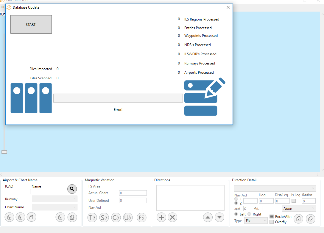

  • I just tried it again and now it says error when I click on Our airports update.
    I just had Norton to exclude anything to do with Nav Date folder and nothing changed. I could disable Norton and try that if you want.

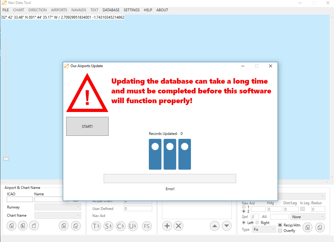

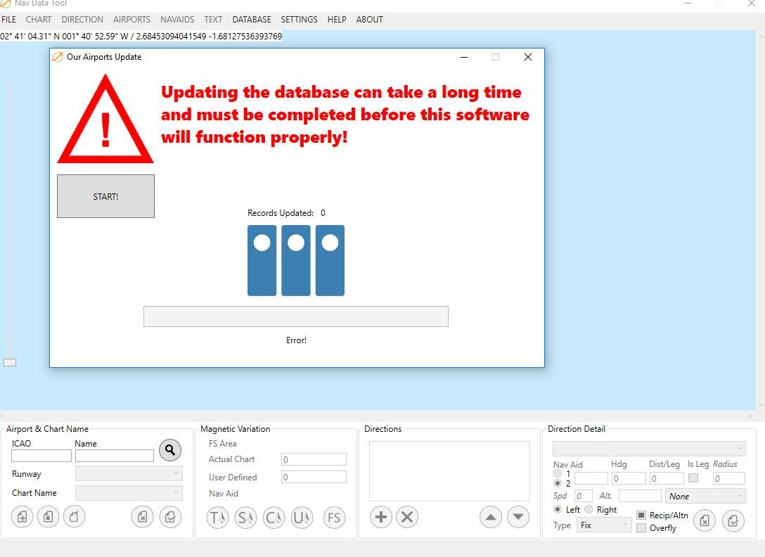

  • For some reason now I get an error on all three updates. I shutdown Nav Data and restarted the computer. After boot up I went directly to the Nav Data Folder and right clicked on the .exe and ran as an admi.
    Do I need to re download the program?
    Tom
  • Today I change the http:// to www.ourairports and tried to make the program work.
    After about five seconds I got a notice that Nav Data quit working.

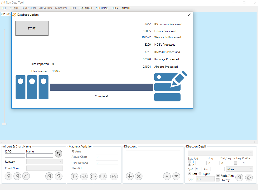

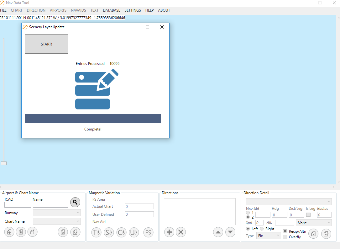

  • Hi Tom,
    I'm still not able to replicate this problem. So as a temporary workaround, I have run the database updates for P3Dv4 and Our Airports on my PC so that you could copy the database to your system.
    So if you download the database from the following link and copy it over the one in Documents\Nav Data Tool you will have no need to run the Our Airports Update.
    https://1drv.ms/u/s!AvmOqBMETlayga1QIYuKFHuEZlhisQ
    I appreciate this is not ideal, but at least you will be able to use the software until I can work out what is happening.
