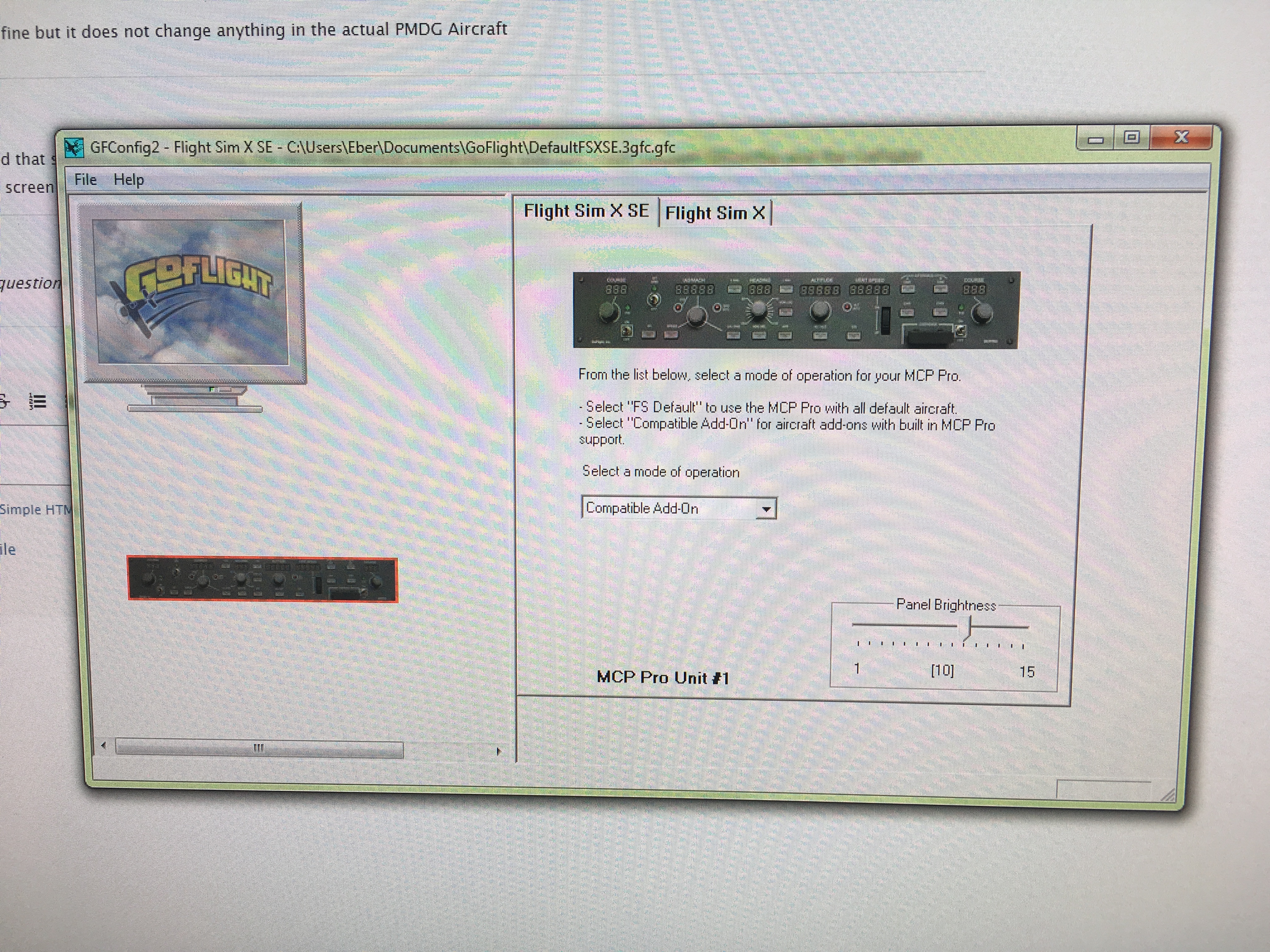

  • OK, so we have proved that something else is driving the MCP PRO which is interfering with GIT. I still suspect GFConfig and the GoFlight drivers. Can you do a screen dump of GFConfig and post it here please.
  • So to confirm you are running FSX Steam Edition and not the standard FSX?
  • Yes, confirmed
