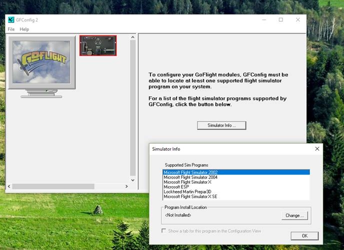

And I can not get it over with X-Plane 11
I downloaded the software from your site but I do not see the X-Plane 11 option

GoFlight does not support X-Plane with their driver software.
If you go to their website here: https://goflightinc.com/pages/latest-software/ you will see two options for X-Plane support. My software here called the GoFlight Interface Tool X-Plane which is payware or a free plugin option that will only work with default aircraft.
