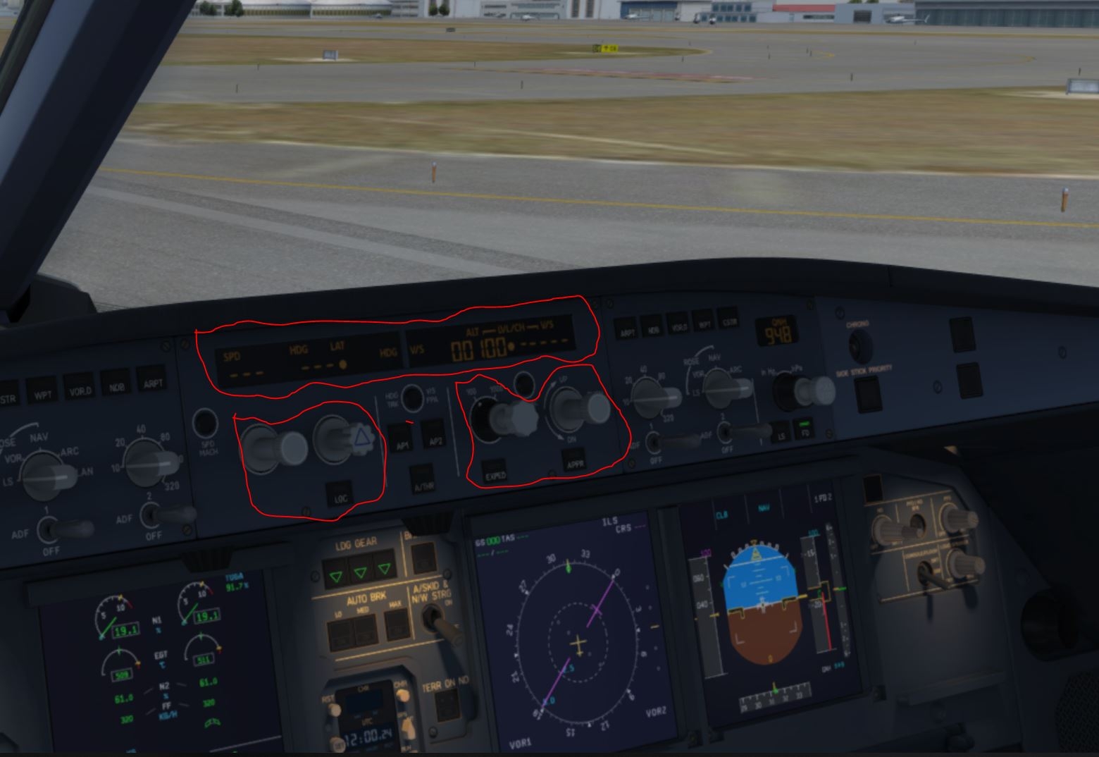

  • Hello C912039
    I came back from vacation and I want to help you on our subject, I send you a photo of the MCP of the aibus A 319 pro of aerosoft, I would like to find the functions on my pro goflight MCP that I put you in red. Can this help you?
    thank you

    I'm back now as well.
    As you may or may not know, the knobs on the Airbus MCP have three operations - rotate, push and pull.
    The display will generally show some digits, or a dot, depending on what mode its in (triggered by you pushing or pulling the knobs).
    Therefore for you to simulate these operations, for each rotational knob on your GF Advanced MCP,you will need to find/use 2 GF buttons, and a GF light.
    That will make it difficult to fit all the functionality on the GF-MCP.
    The MCPPro has many more buttons and lights, and makes it easier to 'retrofit' to Airbus style operations.
    Lets take one of the functions - Heading
    The two modes you can use with the HDG rotary/display - HDG mode and TRACK mode.
    The value to display for HDG display is stored in Lvar AB_AP_HDG_Select
    The rotate function should add or subtract 1 degree from the value stored in LVar AB_AP_HDG_Select, making sure you handle the rollover so if the value ends up > 359 deg, you set it to 0, and if less than 0, you set to 359.
    The value for TRK is stored in LVar AB_AP_TRK_set
    You can work out which mode you are currently in by checking LVar AB_hdgtrk, with it set to 0 if its in HDG mode. If you change the value of AB_hdgtrk to 1, you have switched it to TRK mode.
    This info gives you enough detail to be able to code buttons to go switch from HEADING to TRK mode, and how to illuminate a light if its currently in HEADING mode.
    I hope this helps as a starting point.
    I can provide more LVar details, but the logic and coding for the rest of the features will be more complex than the HDG function Ive described above.
    You probably need to work out where/how you are going to assign all the functions and lights on your existing hardware to facilitate mapping to the Airbus MCP
    Let me know how you progress, and I can then provide the next , more complex function to work on
    Regards
    Regards
