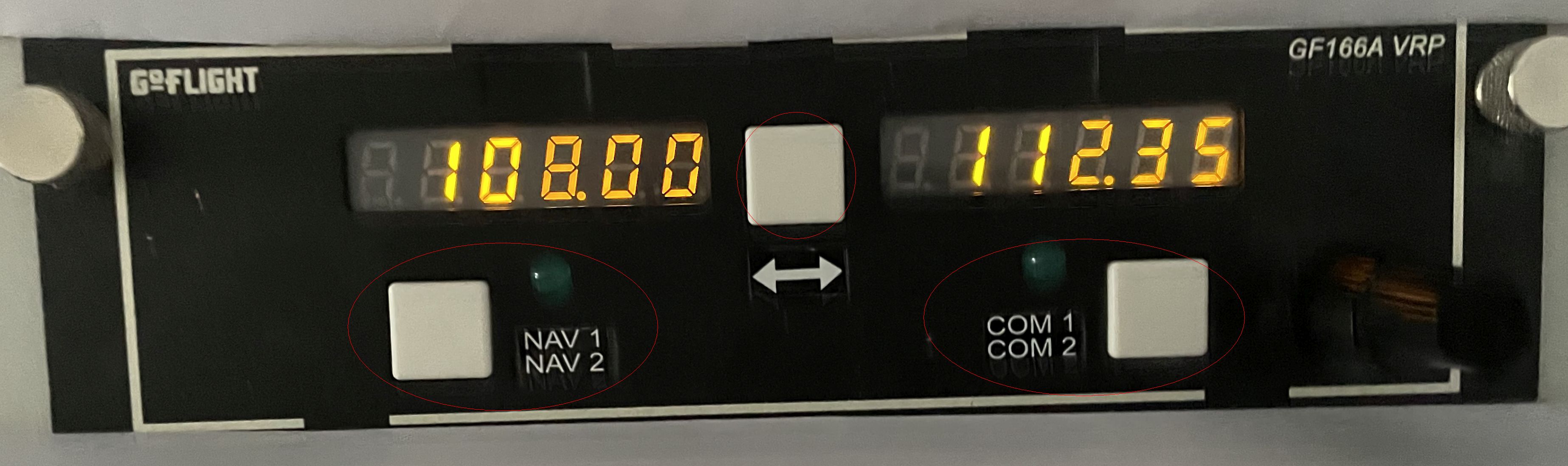

Hello I have a problem to configure the GF-166 in the MSFS2020 for my purpose.
I want the middle button to switch between standby and active
The left button to switch between NAV1 and NAV2
The right button to toggle between Com1 and Com2.
I was able to do this configuration with the original Goflight (FSX) software without any problems.
I ask you to give me the assignments. It does not work with the programmed buttons NAV, COM and ADF. I am desperate.

My concern is very simple.
The left button must switch between NAV1 and NAV2
The right button must switch between COM1 and COM2
The middle button must switch from standby to active.
It shouldn't be that complicated. It worked in the earlier versions.

1 - NAV1
2 - NAV2
3 - COM1
4 - COM2
Since the left, right and centre buttons need different assignments depending on which mode you're on, you will need 12 different button assignments (3 x 4) to make this work. Have a look at the attached pdf. I've taken screenshots of all the control assignments you need for each button.
