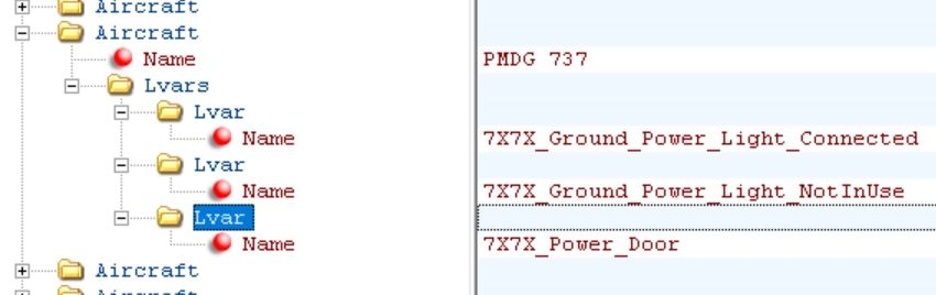

The first scriptexample is working, also notepad is used for editing. checked LUA Manual for Lua Error Code 1 but no luck. Is there something I can do further?
Any variables beginning with DATA are SDK variables so use getkvar instead of getlvar.

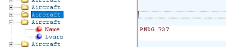

After Starting MSFS and GIT and LUA code assignement, the Lvars were wiped out of the KnownLvars.xml file. The Lvars are not visible in LUA console and the error message is the same as above, it is not working. For the getkvar function I found in the Online LUA description that it is not available in GIT FS2020. So it seems that PMDG B737 in FS2020 did not accept any additional entry, at least for me... (tried with knownlavars.xml writing protection too, but the error message is the same) Best regards Ralf
