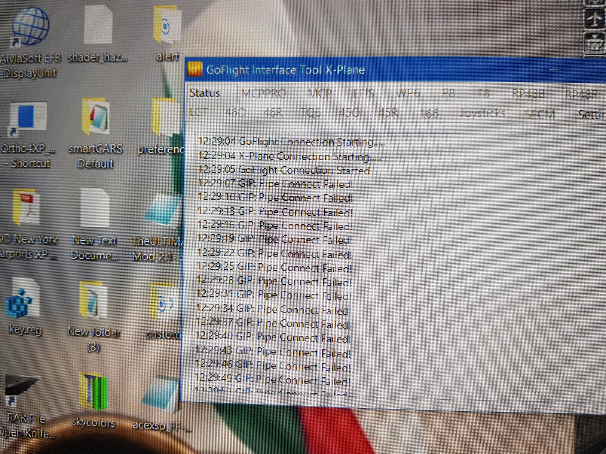

All of a sudden I know get the error GIP:Pipe Connect Failed
It just keeps saying this on the log and I cannot access any functions on the main screen so I have to close it down, sometimes having to use Task Manager to close it

Image of the Log File
What do I rename the Folder to ?
Paul
