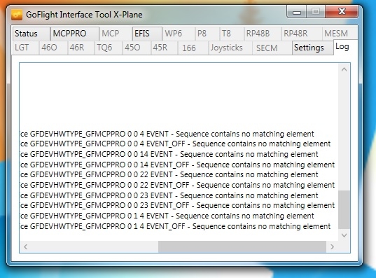

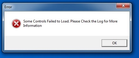

  • Hello Steve, i tried new GIT but still the same Wizard not working and i Unzip the file that you gave it to me then on the MCP PRO tab, click import and select the MCP PRO xml file. I did but some of displays working some not and switches are not working and i getting new error massage.
  • if you do it the manual way need to open detective first and import the bespoke events first. Also need to restart GIT after that because there is a start event in there.
