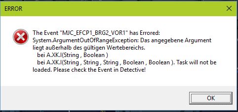

  • Many thanks for the profile of Majestic Dash 8. I installed it and one time it works great. Then suddenly I get error messages for every event "The Event "MJC_EFCP1_BRG2_VOR1" has Errored: System.ArgumentOutOfRangeException...."
    Since this time the MCP Pro and EFIS don't work anymore. Do you have an idea how I can fix this problem?

  • Open detective and take a look at your bespoke events ,if any of them are empty something got corrupted. If that is the case delete all bespoke events and reimport.
     Every time I see that error this has been the case.
    Steve McNitt

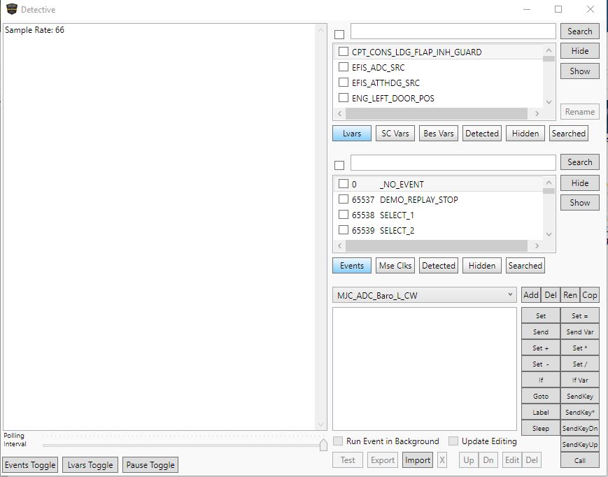

  • This my detective looks like. How I can delete all bespoke events? This red x isn't available. A few days ago I imported the xml files twice and had doubled entries. Then I deleted the 3 xml Userdata files under Documents\GIT an importet the MJC files. At this moment all worked without a problem. After switching between 2 airplanes GIT and P3Dv3.2 screwed up and now the MCP Pro and EFIS doesn't work. I see the right digits at the MCP Pro but if I turn the rotaries they don't work.

  • edited May 2016
    Martin,
    The X isn't showing because the Bespoke Event is empty. Pick a Bespoke Event that isn't empty then click the X.
