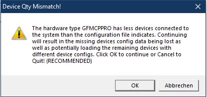

    Now I have the new hubs and the same problem. I make a 3 hours flight with the latest zibo and the profile from steve. I have unchecked the power management at all devices and after 1 hour flight the MCP Pro freezes. The digits are freezed and if I turn the rotaries or use the buttons nothing happens. If I restart GIT I the the message attached.
    If I disconnect the MCP Pro GIT quits and after I reconnect the MCP Pro and restart GIT all is working for the next half an hour.

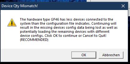

  • Thank's Ray,
    I tested, but last flight my SECM stopped working. Now I get the attached message. This message I got since a few weeks and I clicked on "Ok". Maybe this is the reason for my problems?
    How I can solve this problem without deleting the whole GIT config?
