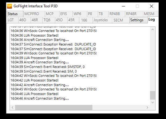

  • Can you post the log please.
  • As per your request.
    rgds
    LCR625
  • Can you copy and paste all the text in the Log, a snapshot is no good.
    rgds
    LCR625
  • The aircraft connection stage isn't completing for some reason. Can you rename Documents\GoFlight Interface Tool so GIT starts up with no config. You will need to re-enable the MCP once you start up GIT.
