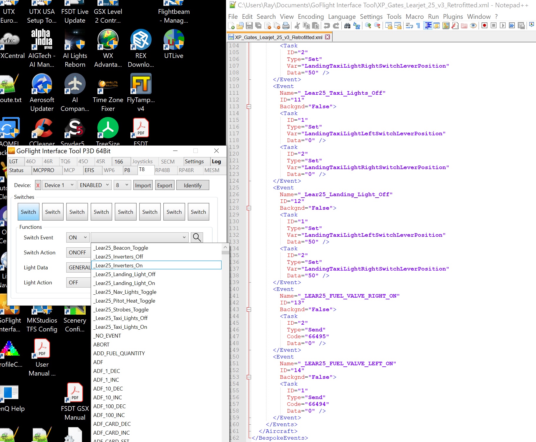

    Could this be a bug or something I have done wrong? I know for sure I created bespoke events for the fuel valves in the Xtreme Prototypes Lear 25. I have used them on previous flights. But if you look at this screenshot you can see they exist in the XP_Gates_Learjet_25_v3_Retrofitted.xml. But look at the list of available events and they don't appear. Why?
    How does GIT know which file to load and from where? Do they have to be in a particular folder? Maybe that's the problem.
    Ray (Cheshire, England)

    I wonder if this might be the reason the fuel valve events are not listed. This is from Settings.xml. They're shown as EventCmd rather than Bespoke. I shall add them via Detective and GIT and see what happens.
    Control ID="0" ACTIONType="EventCmd" ACTION="ONOFF" LIGHTType="SimVar" LIGHT="GENERAL_ENG_FUEL_VALVE1" LIGHTACTIONType="LightCmd" LIGHTACTION="OFF" LIGHTVALUEType="Float" LIGHTVALUE="0" ACTION_OFFType="EventCmd" ACTION_OFF="ONOFF" Control ID="1" ACTIONType="EventCmd" ACTION="ONOFF" LIGHTType="SimVar" LIGHT="GENERAL_ENG_FUEL_VALVE2" LIGHTACTIONType="LightCmd" LIGHTACTION="OFF" LIGHTVALUEType="Float" LIGHTVALUE="0" ACTION_OFFType="EventCmd" ACTION_OFF="ONOFF"
    All xml formatting had to be removed otherwise it doesn't show.

  • I deleted the first two events in settings.xml and save it. Launched GIT and created the two bespoke events which use default FS events, not Lear ones. After adding both to switches 1 and 2 I exited GIT and checked settings.xml. They are shown correctly. So I know that today they were definitely there. If they disappear I'll be back. :)
  • EventCmd is correct. Is the aircraft name associated with the missing bespoke events exactly the same as the one shown in aricraft short name in the settings tab?
  • The two I created today are now shown as Bespoke and appear in Settings.xml and BespokeEvents.xml. Can you explain the difference between EventCmd and Bespoke please?
