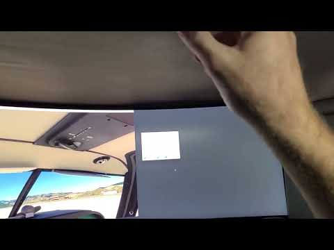

When I have the GIT open I get the 3 green lights for GoFlight, SimConnect and Aircraft expect the Aircraft green light flickers and is not solid. When I use the trim wheel, it stutters and is not smooth. Trimming up takes a lot of turns to move just a little and trimming down is almost 1:1 ratio and is for the most part working normal. I created a video to show the issue.
https://youtu.be/j-JbbysvhL0
This is with the A2A Comanche and is the only plane I use in MSFS. Any idea or help on how to fix this would be greatly appreciated.

Double check the events and event actions for trim up and make sure they are correct. If you clicked Default FS then they should be fine, but no harm in clicking that button again if you didn't make any other changes to the LGT config.
Assuming it does the same thing with different aircraft, its most likely a faulty rotary encoder. See this thread for a possible solution (even though its for an mcp rotary, its the same tech): https://www.pollypotsoftware.org.uk/vanillaforums/discussion/2008/goflight-mcp-pro-knobs-not-responding-to-039-fast-039-turns#latest
