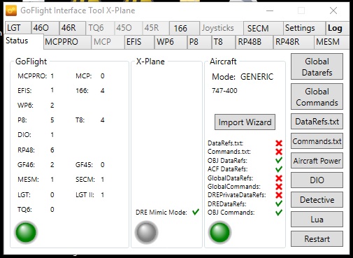

Problem: Exit XP11 GIT becomes unresponsive
Steps to replicate:
1. Load GIT 2.0.11.0
2. Start XP11
3. Select default 747
4. switch from full screen to window mode and back to full screen
5. exit XP11
see attached picture of the state GIT is in when it becomes unresponsive ... note the GIT windows can't be moved, requires taskmgr to end task OR you have to wait upto 5-10 minutes then GIT will CTD with the follow OS event error log:
Steps to replicate:
2. Start XP11
5. exit XP11
