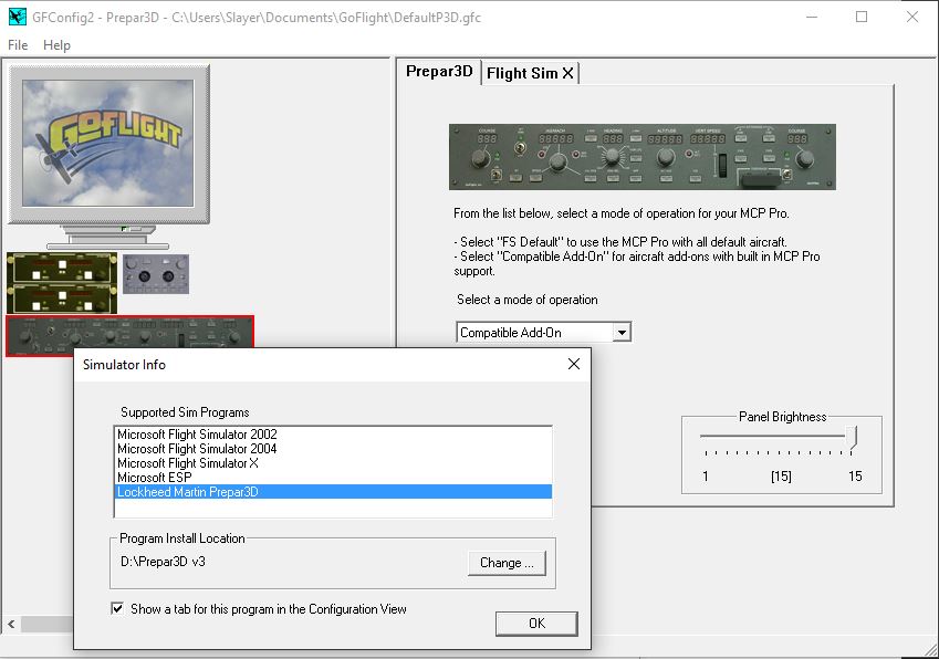

  • edited February 2016
    I've seen it have all zeros before. It's because of not being set to compatible addon in GFConfig. Make double sure you have your P3D entries set correctly in options /program locations. Especially if you have 2.5 and 3.1 installed as they are not the same directory.
    Steve McNitt
