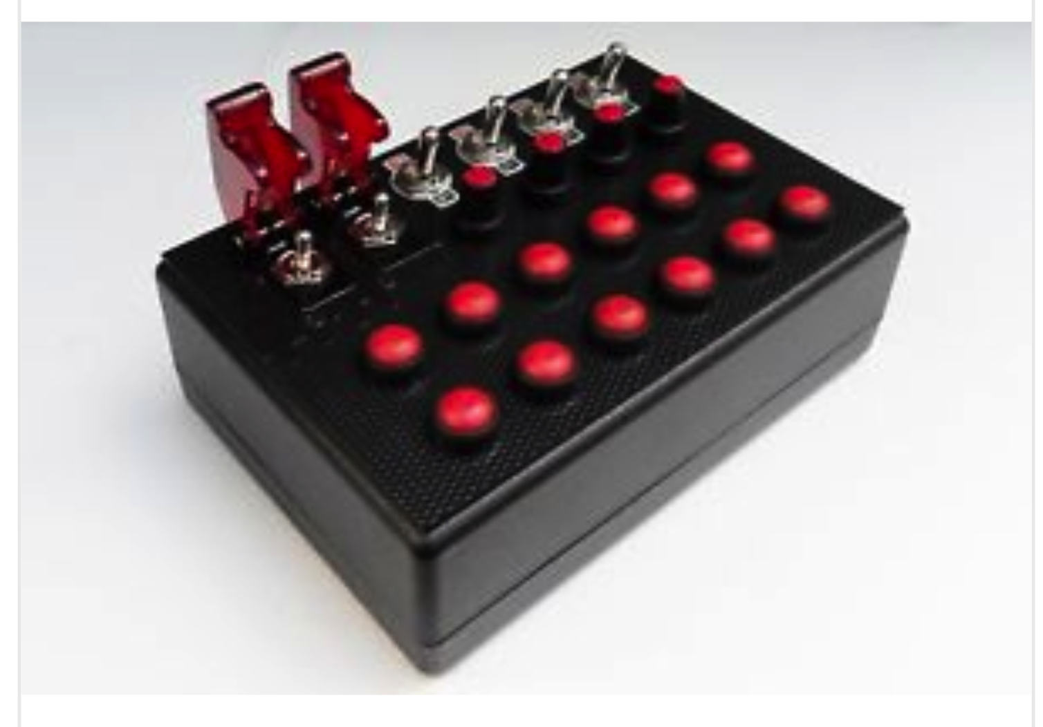

Hello I wonder if the tool interface can handle this: I have the FSX-Steam with PMDG, just got a bbjsimracing 30 buttons box, it has buttons and rotary encoders, When I try to add the key in the B777 PMDG there is only keyboard option and the PMDG does not show button pressed, the box is working I map all buttons, I can not set the rotary buttons to increase/decrease IAS, HDG, V/S or Altitude. Any help is more than welcome.

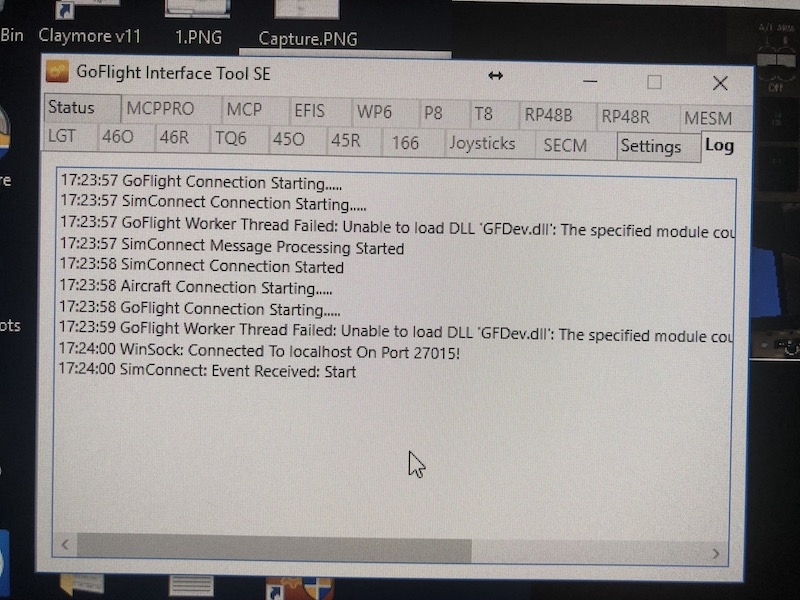

  • sorry just found, have installed running but can not open any other tab, in the Log there is an error: threat failed unable to load DLL GFDev.dll.
    The app freezes after 2 minutes.... to close I have open the Task Manager :(

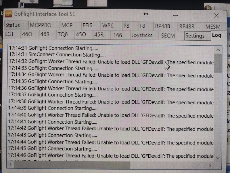

  • this was taken after start the FSX Steam and freezes again :(
    You need to follow the installation steps even though you have no GoFlight equipment: https://www.pollypotsoftware.org.uk/support/user-guide/user-guide-git/16-installation/14-installation.html
    You will then need to enable Joysticks in the settings tab.
  • Hi Steve, I don't have any of the MCPs mention on your user guide... What should I install? Where can I find the drivers your app needs?
  • Drivers are here: https://goflightinc.com/pages/latest-software/ Click the Download GFConfig button.
    There is no need to do anything in GFConfig because you don't have any GoFlight gear. Just install the drivers and GIT into the same directory and it should fire up OK. Remember to enable Joysticks in the Settings tab.

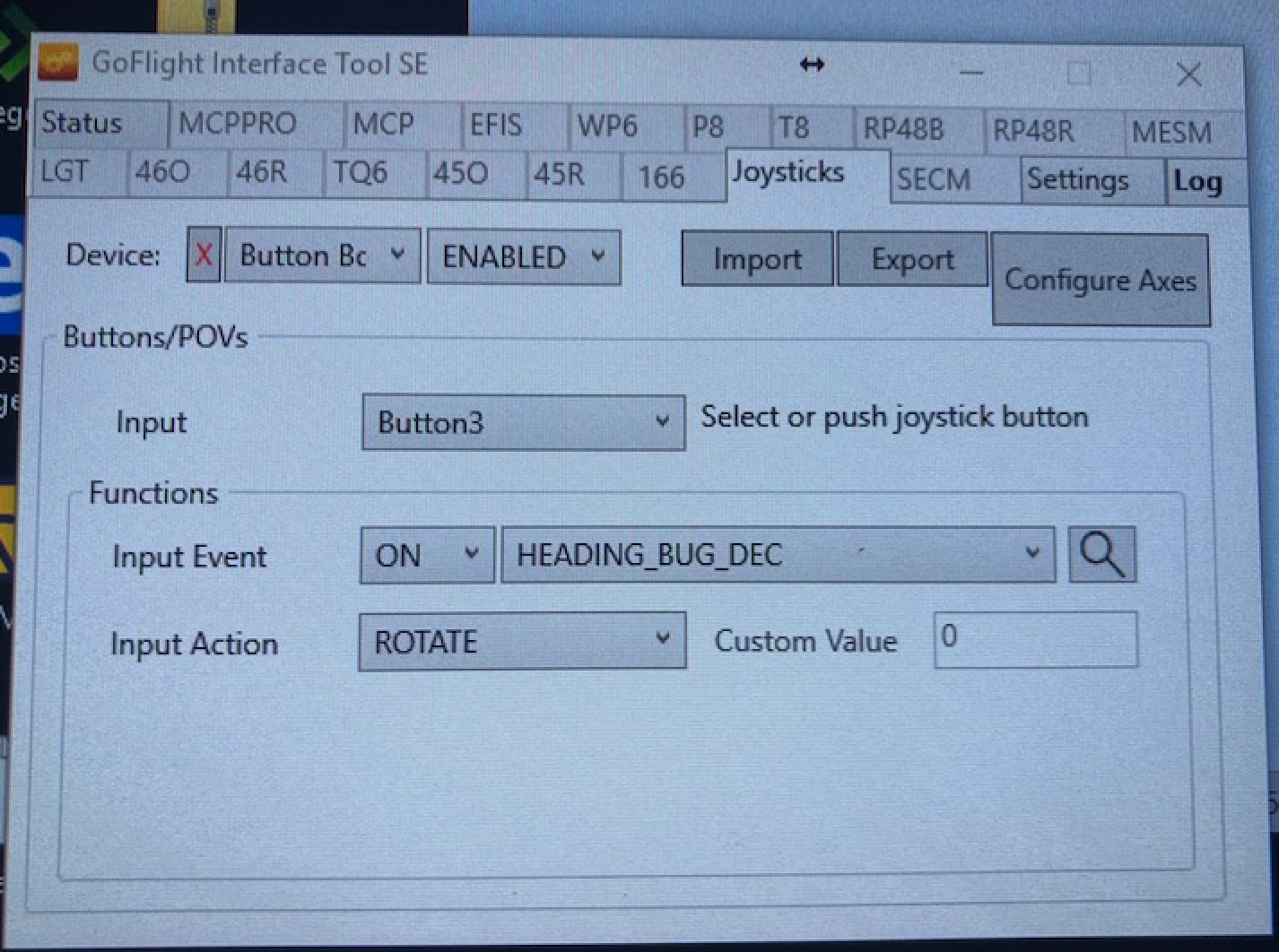

  • Hi Steve, first of all sorry for my lack of knowledge with FSX and your app, I follow your instructions, and be able to open the joystick TAB, on Device Field dropdown Button Box Interface I will attach a picture, so when I move the rotary button 3-left-decrease or 4-right-increase I can see the input Event chaining to Heading_Bug_INC to Heading_Bug_DEC. but no action in the HDG of the FSX/PMDG.
  • Hi Steve, I select EVT_MCP_HEADING_SELECTOR to a Button4 so I can increase the HDG bug, but How can I decrease? if I select same EVT to button 3 still increases the HDG bug. There is no EVT INC or DEC?
    You need to use an Input Action. If you think about using the Virtual Cockpit, a left mouse click decreases the heading and a right mouse click increases it. So use Input Action MOUSELEFT on one button and MOUSERIGHT on the other using EVT_MCP_HEADING_SELECTOR on both buttons.
